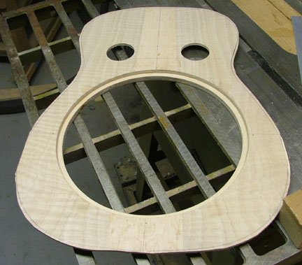

Squareneck, styled after a Scheerhorn L model. The top and back are 3-pieces, flamed maple with a birdseye center wedge. I'm not sure what I will do for the finish, except to say that I will probably do a burst of some color.
The images look a little funky-shaped because of the angle, but they should give you an idea what it's gonna be like. The flamed maple is from Lowes...

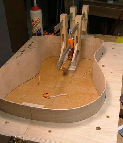

This maple is a soft variety that I picked up from my local Lowes. It bends almost by itself. I say "almost". I bent it with a heat blanket, really thick, without a whole lot of heat, with a good spritzing of water. Very minimal discoloration from the water, and that was it. In fact, I touched up the bends on the pipe afterward, and over-bent the waist. So all I did was spritz that area with some water, forced the bend open with my hands, and clamped into the outside mold and the shape held. It was the easiest wood to bend I've ever used.

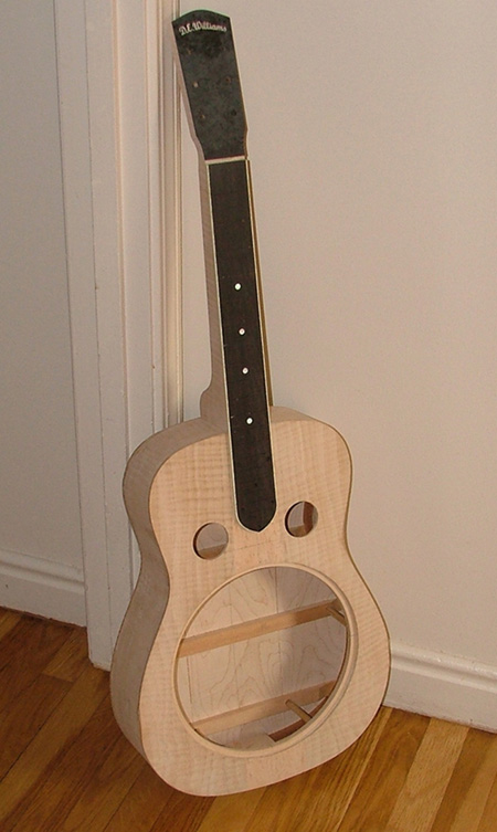

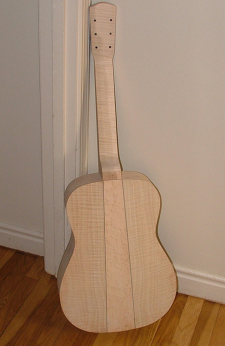

I thought I'd show a couple pics of where my reso project is currently at....
here's the front
and the back
thanks for lookin'!

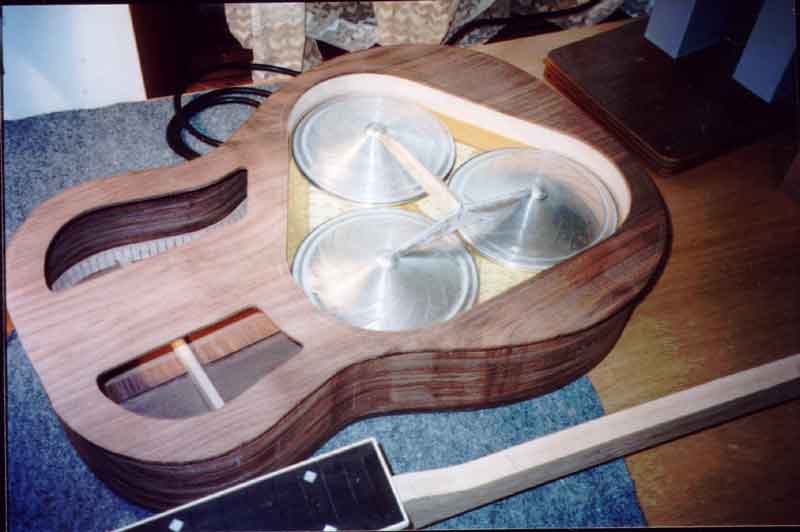

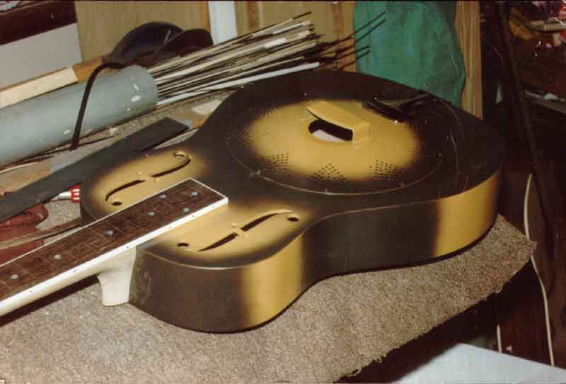

Here are a couple of pictures of past resophonic guitars ,
both showing the necks in "the white".
One is a "tricone" the other a "Triolian" single cone.
I hope they are of some interest .
